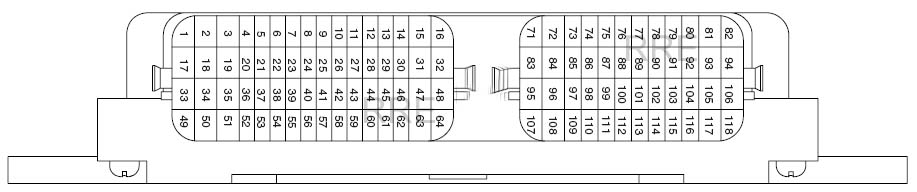

Pin NO: | Description |
1 | Intake Cam engine oil control valve |
2 | No.1 injector |
3 | No.2 injector |
4 | No.1 ignition coil (ignition power transistor) |
5 | No.2 ignition coil (ignition power transistor) |
6 | Starter active signal |
7 | Exhaust camshaft position sensor |
8 | Crankshaft position sensor |
9 | Sensor supplied voltage |
10 | Throttle position sensor (main) |
11 | Throttle position sensor (sub) |
12 | Power supply voltage applied to throttle position sensor |
13 | Throttle position sensor ground |
14 | Intake camshaft position sensor |
15 | Throttle actuator control motor (+) |
16 | Throttle actuator control motor (-) |
17 | Exhaust Cam engine oil control valve |
18 | No.3 injector |
19 | No.4 injector |
20 | No.3 ignition coil (ignition power transistor) |
21 | No.4 ignition coil (ignition power transistor) |
23 | Exhaust camshaft position sensor ground |
24 | Crankshaft position sensor ground |
25 | Knock sensor (+) |
26 | Engine coolant temperature sensor |
27 | Engine coolant temperature sensor ground |
30 | Intake camshaft position sensor ground |
34 | Heated oxygen sensor (front) heater |
35 | Heated oxygen sensor (rear) heater |
36 | Engine oil pressure switch |
37 | Evaporative emission purge solenoid |
38 | Heated oxygen sensor (front) |
39 | Heated oxygen sensor (front) offset voltage |
40 | Heated oxygen sensor (rear) |
41 | Heated oxygen sensor (rear) offset voltage |
42 | Knock sensor (−) |
44 | Power supply voltage applied to manifold absolute pressure sensor |
45 | Manifold absolute pressure sensor |
46 | Manifold absolute pressure sensor ground |
51 | Fuel pump relay 1 |
52 | Turbocharger wastegate solenoid 1 |
53 | Turbocharger wastegate solenoid 2 |
58 | Power steering pressure switch |
60 | Generator G terminal |
61 | Generator FR terminal |
62 | Generator L terminal |
71 | Throttle actuator control motor ground |
72 | Throttle actuator control motor power supply |
73 | MFI relay (power supply) |
74 | Accelerator pedal position sensor (main) |
75 | Power supply voltage applied to accelerator pedal position sensor (main) 76 |
77 | Accelerator pedal position sensor (sub) |
78 | Power supply voltage applied to accelerator pedal position sensor (sub) |
79 | Accelerator pedal position sensor (sub) ground |
80 | OBD pin7 connector (K-LINE) |
81 | ECM ground 82 Power supply |
83 | Throttle actuator control motor ground |
84 | Throttle actuator control motor relay |
85 | Clutch pedal position switch <M/T> |
87 | Mass airflow sensor |
88 | Mass airflow sensor ground |
89 | Intake air temperature sensor 1 |
90 | CAN interface (high) |
91 | CAN interface (low) |
92 | Ignition switch-IG |
93 | ECM ground |
95 | Cruise control button set input |
96 | Fuel pump relay 2 |
97 | Intake air temperature sensor 2 ground |
98 | Intake air temperature sensor 2 |
102 | A/C compressor relay |
103 | Flash EP-ROM power supply |
104 | Backup power supply |
105 | Ignition switch-ST |
106 | Starter relay |
107 | Cruise control button set supply voltage |
108 | Brake/stop light switch (cruise control system) |
112 | Fuel tank differential pressure sensor |
113 | Fuel tank differential pressure sensor ground |
114 | Power supply voltage applied to fuel tank differential pressure sensor |
115 | Fuel tank temperature sensor |
117 | Evaporative emission ventilation solenoid |
