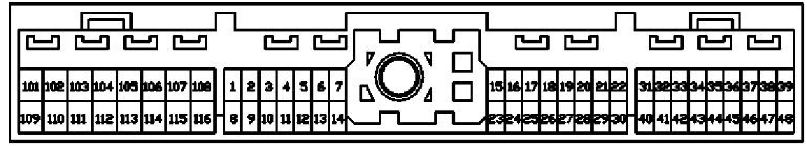

Konu: Nissan 200Sx S14A Ecu pinout
    TechTurkey Oz` - ait Kullanıcı Resmi (Avatar)
    20.Ekim.2005
    8,528
    Nissan Silvia 200Sx S14A
    Pin NO: Description
    1 Coil 1 Output
    2 Tachometer Signal
    3 Coil 2 Output
    4 ECCS Self-Shutoff Relay
    5 Coil 3 Output
    6 ECCS Ground
    7 Data Link Connector
    8 NATS Immobilizer
    9 Cooling Fan Low Speed
    10 Cooling Fan High Speed
    11 Air Conditioner Relay
    12 A/T Signal No. 3
    13 ECCS Ground
    14 Diagnostics Clock
    15 Data Link Connector
    16 Mass Air Flow Sensor
    17 Mass Air Flow Ground
    18 Engine Coolant Temperature Sensor
    19 Oxygen Sensor
    20 Throttle Position Sensor
    21 Sensor Ground
    22 Crankshaft Reference Signal
    23 Data Link Connector
    24 Malfunction Indicator Light
    25 Coil 4 Output
    26 NATS Immobilizer
    27 Knock Sensor
    28 Throttle Position Sensor Signal Output
    29 Sensor Ground
    30 Crankshaft Reference Signal
    31 Crankshaft Position Signal
    32 Vehicle Speed
    33 Electrical Load Signal
    34 Start Signal
    35 Neutral Position Switch
    36 Ignition Switch
    37 Throttle Position Sensor Power Supply
    38 Power Supply for ECM
    39 ECCS Ground
    40 Crankshaft Position Signal
    41 Air Conditioner Switch
    42 A/T Signal No. 1
    43 Power Steering Oil Pressure Switch
    44 A/T Signal No. 2
    45 A/T Signal No. 1
    46 Back-Up Power Supply
    47 Power Supply for ECM
    48 ECCS Ground
    101 Injector No.1
    102 Wastegate Control Solenoid
    103 Injector No.3
    104 Fuel Pump Relay
    105 EGR Valve
    106 Fuel Pump Relay (S14 & S15)
    107 ECCS Ground
    108 ECCS Ground
    109 Reverse Electrical Flow Return Circuit
    110 Injector No.2
    111 Front O2 Sensor Heater
    112 Injector No.4
    113 Idle Auxiliary Air Control Valve
    114 VTC Solenoid Valve
    115 Wastegate Solenoid
    116 ECCS Ground

    Kafamda hep bi soru işareti var
    7400 gibi bi cevirme oluyor idi over drive var iken
    şimdi manuele cevirdik aracı
    7000 devirde kesicide
    Over drive i aktif etmek icin
    A/T baglantı fonksionları nasıl aktif hale geliyor kafamı karıştıran konu bu yani over drive
    23.Şubat.2013
    51
    Aracın yaş ve özelliklerine göre beyin değişebiliyor bu beyin 1996 modellerde çıkıyor genellikle
    AEAlmas - ait Kullanıcı Resmi (Avatar)
    06.Temmuz.2011
    Antalya/Baghdad/Adelaide
    3,877
    96 model ve üstü araclarda mevcut türkiye de durum bu şekilde ama amerikada red top denilen kapaktaki s14 sr20 det ler ca18det le ayni pin out u kullanmakta
