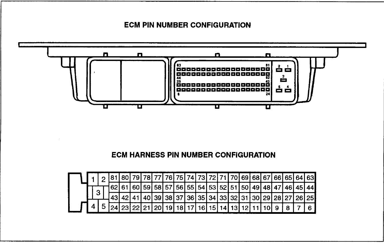

1) sensor heating 0.5G/B (dmtl)
2) ignition coil "1" control 1.25L (cyl "2"3")
3) ignition ground 2.0B
4) *
5) ignition coil "2" control 1.25Br (cyl "1"4")
6) injector 2 control 0.5B/O
7) injector 3 control 0.5Br
8) engine rpm signal 0.3Gr
9) tps signal 0.3P
10) torque reduction signal (Automatic Only) 0.3W/B (tcm)
11) fuel consumption/injection signal (LC2 Only) 0.5L
12) memory power/battery voltage supply 0.5O/B
13) on/start input 0.5O
14) engine control relay control 0.5Gr/O
15) ground "A" (cps)0.3Br
16) sensor signal 0.5G (tps)
17) sensor ground 0.5G (tps, dlc, acs)
18) sensor signal0.5G/B (O2 sensor up)
19) sensor signal 0.5O (knock sensor)
20) sensor ground 0.5L (knock sensor)
21) fuel gauge 0.3G/B
22) mil request line (Automatic Only) 0.3Y/B (tcm)
23) *
24) cooling signal input 0.3Y/B
25) solenoid control 0.5P/B (dmtl)
26) close 0.5Y (isa)
27) injector 1 control 0.5Br/B
28) sensor heating 0.5O (O2 sensor down)
29) open 0.5Br (idle speed acuator)
30) pump control 0.5Y/B (diagnosis module for tank leakage)
31) check engine indicator control 0.3W (cel)
32) sensor power 5v 0.5G/B (tps)(acs)
33) sensor power (maf) 0.5R/O & sensor power (map) 0.5L/O
34) sensor power "B" 0.3W (cps)
35) sensor ground 0.5B (O2 sensor down, engine coolant temp sensor & sender)
36) sensor ground 0.5B (O2 sensor up, maf, map)
37) (maf)afs signal 0.5L () (map) map signal 0.5L
38) *
39) sensor signal 0.3P (ect)
40) *
41) *
42) (maf)ats signal 0.5Y () (map)iat signal 0.5Y
43) *
44) battery voltage 0.5P/B
45) battery voltage 0.5P/B
46) pvc control 0.5L/O
47) injector 4 control 0.5B/O
48) sensor heating 0.5Gr/B (O2 sensor up)
49) "immo" indicator control 0.5 G/O (not used)
50) fan relay control high 0.3Y
51) ground 0.5B
52) signal "smatra" 0.5Br (not used)
53) ground 0.5B
54) *
55) sensor signal 0.5G/O (O2 sensor down)
56) *
57) a/c signal input 0.3P
58) *
59) vehicle speed signal 0.3L/B (tcm)
60) sensor signal 0.3G/O (accelerator sensor)
61) ground 0.5B
62) *
63) battery voltage 0.5P/B
64) *
65) *
66) *
67) *
68) fan relay control low 0.3Y/B
69) a/c relay control 0.5Br
70) feul pump control relay 0.5G/B
71) k-line 0.3R (tcm, dlc)
72) torque reduction request 0.3O (tcm)
73) (m/t) battery voltage 0.5P/B () (a/t) drive position switch "D"2"L" 0.3P/B
74) (m/t) battery voltage 0.5R () (a/t) drive position switch "R" 0.5R
75) a/c switch "on" input 0.5P
76) *
77) *
78) ground, MT/AT Encoding (Automatic Only) 0.5B
79) sensor signal 0.3W/B (cmp)
80) ground 0.3B
81) *
