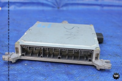

    2000-2004 Honda S2000 Ecu pinout
    Pin # 2000-2004 Honda S2000
    A1 Engine Coolant Temp Gauge
    A2 Air Control Valve
    A3 EVAP Bypass Solenoid Valve
    A4 EVAP Control Canister Vent
    A6 EVAP Purge Control Solenoid
    A9 Vehicle Speed Sensor
    A10 Service Check Signal
    A12 Immobilizer Indicator Light
    A13 Immobilizer Enable Signal
    A15 Fuel Pump Relay
    A17 A/C Clutch Relay
    A18 Malfunction Indicator Light
    A19 Engine Speed Pulse
    A20 Radiator Fan Control
    A21 K-Line
    A24 Starter Switch Signal
    A25 Immobilizer Code
    A26 Electrical Power Steering Load Detect
    A27 A/C Switch Signal
    A28 Air Pump Relay
    A29 Fuel Tank Pressure Sensor
    A30 Electrical Load Detector
    A32 Brake Switch Signal
    B1 Power Source 1
    B2 Power Ground 1
    B3 Injector 2
    B4 Injector 3
    B5 Injector 4
    B9 Power Source 2
    B10 Power Ground 2
    B11 Injector 1
    B12 VTEC Solenoid Valve
    B20 Logic Ground 1
    B21 Voltage Back Up
    B22 Logic Ground 2
    B23 Idle Air Control Valve
    C1 Primary O2 Heater Control
    C2 Alternator Control
    C4 Ignition Coil Pulse No. 1
    C5 Alternator FR Signal
    C7 Sensor Ground 1
    C8 CKP +
    C9 CKP -
    C10 VTEC Pressure Switch Signal
    C11 Secondary O2 Heater Control
    C12 Ignition Coil Pulse No. 2
    C13 Ignition Coil Pulse No. 3
    C14 Ignition Coil Pulse No. 4
    C15 Secondary O2 Sensor
    C16 Primary O2 Sensor
    C17 MAP Sensor
    C18 Sensor Ground 2
    C19 Sensor Voltage 1
    C20 TDC1 +
    C21 TDC1 -
    C22 Knock Sensor
    C24 Air Pump Electric Current Sensor
    C25 Intake Air Temperature Sensor
    C26 Engine Coolant Temperature Sensor
    C27 Throttle Position Sensor
    C28 Sensor Voltage 2
    C29 TDC2 +
    C30 TDC2 -
