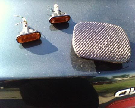

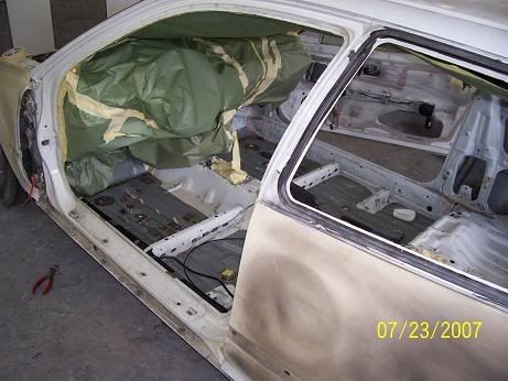

Konu: k26 eg project
    ugur - ait Kullanıcı Resmi (Avatar)
    474

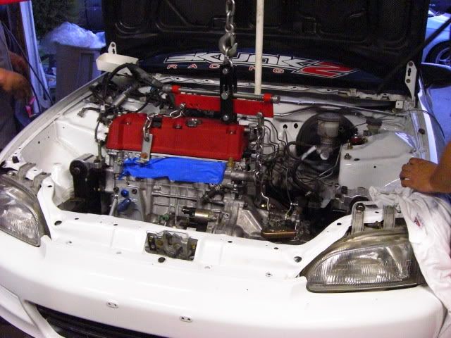

    k26 eg project
    K24a4 accord block

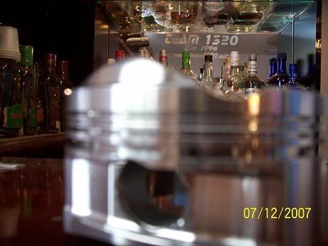

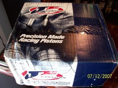

    custom cp pistons 14:5:1
    88mm bore
    crower maxi lite rods
    new rings, bearings and HG
    05 type s oil pump conversion
    type s oil pan

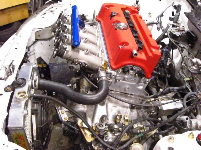

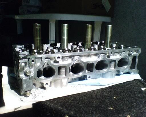

    K20a2 rsx type s head
    crower valve springs and retainers
    crower stage 3 cams
    AEBS High Performance Head Stud kit
    04' rsx type s 6 speed tranny

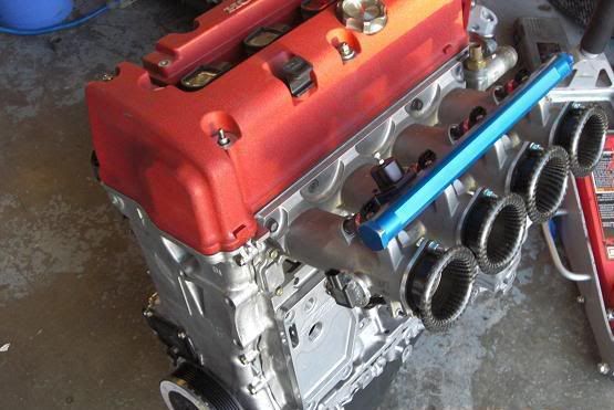

    rbc intake manifold
    hondata intake gasket
    Karcept tb adaptor

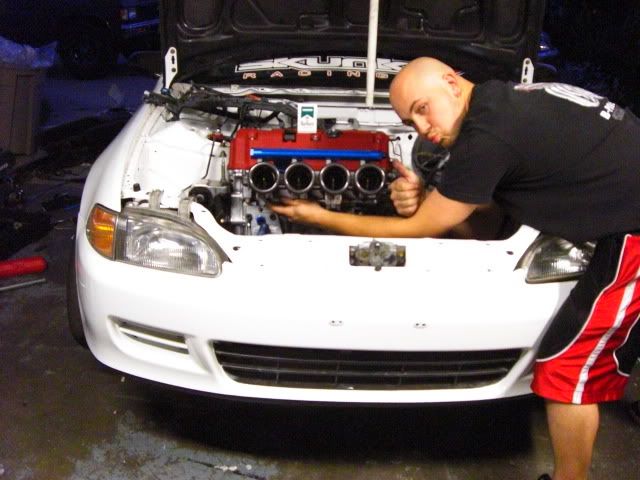

    70mm bdl tb/ (NEW UPDATE!!! TWM 54mm CF stacks itb's)
    AEM K-Series Swap Intake for Civic EG / Integra DC2
    550cc rc injectors
    golden eagle fuel rail
    aem feul pressure regulator
    hondata kpro with dell lap top
    Hybrid-Racing wire Conversion Harness
    fluidyne radiator
    NRG-CELL Slim Racing Battery
    gsr brake booster
    gsr front and rear suspension
    Karcepts Shifter Mounting Kit
    Karcept radiator and reservoir relocate brackets

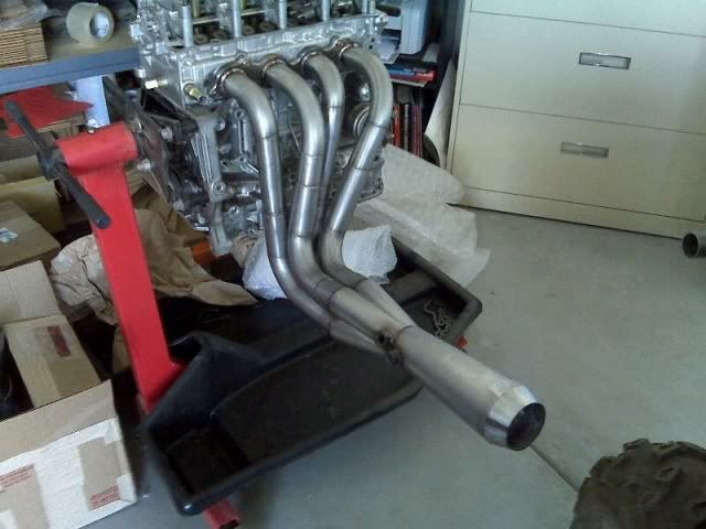

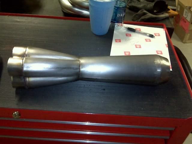

    R crew header
    3" exhaust with a 3" apexi n1 muffler
    electric cut out so i can run open header at the push of a button
    R crew axels
    Hasport mounts 88a
    cf hood
    cf lip
    cf rear spoon wing
    cf spoon mirrors
    cf spark plug cover
    jdm K20A Type R black dip stick
    jdm K20A Type R valve cover
    jdm K20a Type R (DC5) 6 speed shift knob
    jdm sun visors
    jdm coin pocket
    jdm amber cluster
    jdm amber clock
    jdm arm rest
    jdm center console
    jdm front head lights
    jdm corners
    jdm rear tail lights all four
    usdm mud guards

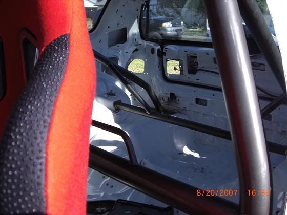

    auto power 4 point roll cage
    replica/mugen rear upper strut bar
    em rear pillar bars
    jic 16 way adjustable suspension
    Nology ground wires
    blox extended studs
    skunk2 aluminum/magnesium lug nuts
    15x8 old school gold, AXIS OG Original Goods
    bfg drag radials 205/15/50 in the front
    falken azeins195/15/50 in the rear
