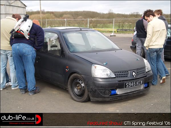

    tt motorlu bır clıooo saka makınası yapmıs arkadas... ozelliklerini bulamadım ama 400 hp civarındaymıs..
    buda vıdeosu
    http://www.youtube.com/watch?v=Ss8Mupq5vbc
    MuratB - ait Kullanıcı Resmi (Avatar)
    Karşıyaka
    1.580
    specleri benden olsun
    Clio TT 1.9 Turbo
    ENGINE SPEC
    Audi S3 engine
    Golf GT TDi 6 speed box
    Quaiffe LSD
    DTA engine management system
    Subaru STi VF34 high output Turbo
    HKS intercooler
    HKS water injection system
    Jabba sport ceramic gasflowed manifold
    Jabba sport 440 green injectors
    Jabba sport forged pistons
    Jabba sport steel con rods
    Engine increased from 1.8 to 1.9
    lightened and balanced crank
    lightened and balanced flywheel
    Sachs performance clutch
    HKS oil cooler
    Ramcharge filter system
    3.5" stainless steel exhaust
    Blue flame performance Down pipe ( custom made )
    Forge piston dump valve
    RUNNING GEAR
    Clio 172 front and rear disc brakes
    Clio 172 front and rear calipers
    Koni FK adjustable coilovers
    OMP front & rear strut braces
    Steel 15" rims running Yoko 205 / 50 / 15 tyres
    Renault sport anti roll bar
    polyurethane wishbone bushes
    Audt TT polyurethane upgraded eng mounts
    polyurethane anti roll bar bushes
    Yozza sport braided hoses ( brakes )
    clio 172 brake servo
    BODYWORK
    standard
    Was previously set up at 336 bhp // 360 lbft
    Engine re-build currently in operation should see
    well in excess of 400 bhp ... recorded 0 - 60 mph
    of 4.1 seconds - 175 mph top speed
    Has run a 12.4 @ 118 mph ( Elvington air field )
