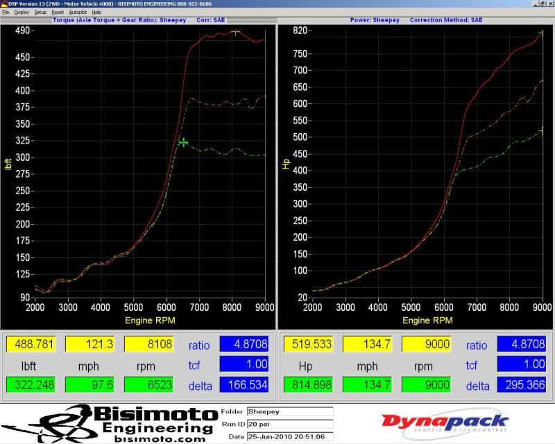

    Turbo Civic görülmeye değer..
    2L 10.1:1 JE pistons
    Manley turbo tuff LS rods
    89mm crank
    GSR head
    skunk2 pro series springs ,ret and valves
    GSR Tranny w/ quafe diff
    Comp Clutch twindisc setup
    Titlon throw out bearing assembly
    JDL front mount t4 divided manifold, down pipe and tubes all swaintech coated
    dual 44 Tial gates
    Bullseye s368 w/ 1.10 ar
    Garrett 18x12x4.5 core with custom end tanks
    Full Race Intake mani
    BDL 72mm TB
    AEM Series 2 ECU
    M&W pro 14 ignition with CBR coils
    Custom enclosed Relay box w/ Milspec plug
    t1 Camtrigger
    Racepak IQ3 display dash
    the entire harness was custom built to my specs by my good friend Ryan @ Rywire
    T1 ID2000s w/ skunk2 rail
    Fuel Lab reg
    Dual bosch 044 pumps
    T1 catch can
    Skunk2 Pro C suspension with drag rear spring rates along with their LCAs
    Exospeed 3 piece front end
    Exospeed star8 13x9 up front and 15x 3.5 rears
    Failure is not an option.
    5.314
    and the graphs
    spring pressure 14 psi run, 20 psi run and 31..

    814hp de çılgın bir değer
