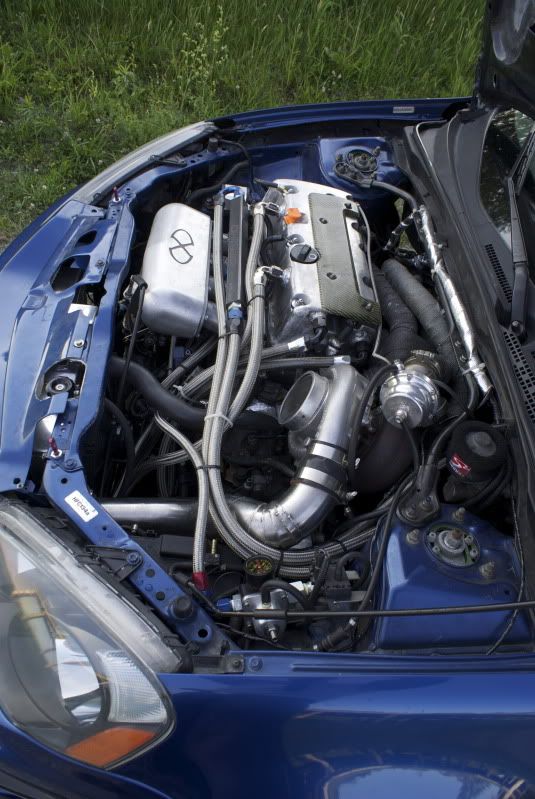

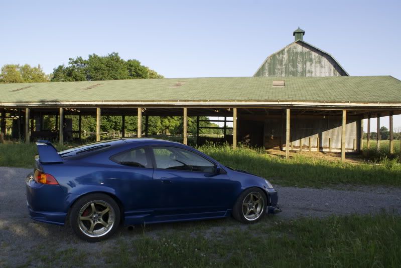

    2002 TURBO RSX-S 27psi 660whp 440tq Race Gas
    TUNE WAS DONE ON MUSTANG DYNO, I WAS ON MY 18 X 9 RIMS WITH 275/40/18 TIRES AND BIG BRAKE KIT THE EXTRA ROTATIONAL WEIGHT SURE DIDNT HELP MY DYNO NUMBERS BUT I WILL TAKE TRACTION OVER POWER ANY DAY
    Motor k20a2
    KPRO
    HONDATA 4BAR Map Sensor
    Turbo GT4094R 1.06AR BALL BARRING
    Full Race Twin Scroll T4 Manifold
    2 Tial 44mm Waste Gates
    TIAL 50MM BOV
    1300Hp Custom Vertical Flow Intercooler
    Custom 3 Inch Intercooler Piping
    Full Race 3 Inch Down Pipe
    Custom 3 Inch Exhaust Exits on the side
    Xcessive K-PRO Intake Manifold
    90mm Throttle Body
    Fluidyne Heavy Duty Oil Cooler
    IPS KT1 Turbo Cams
    Eibach EVS with Ti Retainers
    Benson Sleevs Machined by Laskey Racing
    CP Pistons
    Pauter Rods
    Fast Turbo Fuel System 044 Bosh External Fueal Pump
    1600cc Precision Injectors
    Golden Eagle Fuel Rail
    Weldon Fuel Pressure Regulator
    Spoon Carbon Fiber Spark Plug Cover
    JDM type R Engine Cover
    Avid Racing Motor Mounts
    T1 Race Development Breather Box
    Koyo Racing Radiator with High Flow 13" Spal Fan 18 amp motor
    Suspension
    Tein Flex Coilovers
    Authentic Mugen Front and Rear Strut Bars
    Progress Rear Sway Bar Adjustable
    Progress Front Sway Bar 27mm
    Beaks Tie Bar
    Transmission
    PAR Honda K-Series 1st~4th dog engagement gearset
    Ratios i chose for turbo drag applications - 2.83, 1.92, 1.31, 1.05 i will be using stock 5th
    Straight cut 4.27 ratio final drive
    Tilton Twin Disc Cerametallic Clutch
    Tilton Release Bearing Kit: Cerametallic Clutch
    Quife LSD
    Wheels for the street
    18 x 9 Valks SF Challenge Bronze
    Street Tires
    275/40/18 Front Azenis 615
    255/45/18 Rear Azenis 615
    Drag Wheels
    15 x 9 Exospeed
    Slicks
    26 x 10 M/H
    Brakes
    KVR Phantom Big Brake Kit

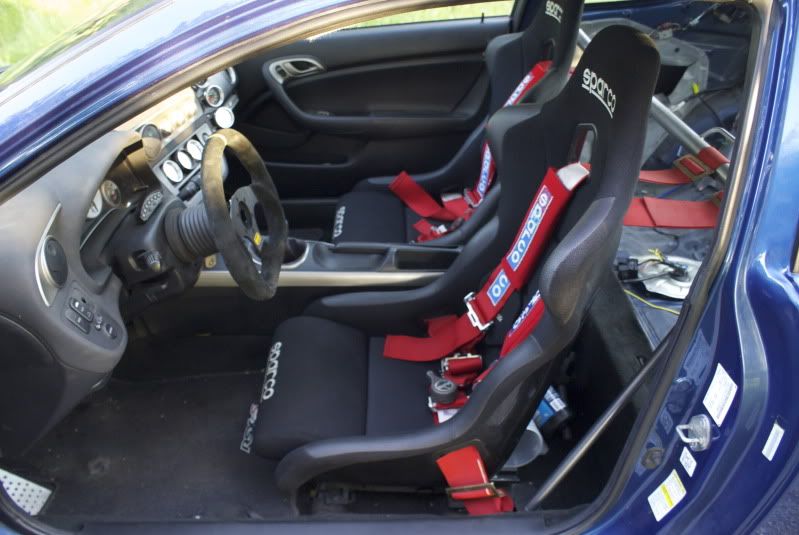

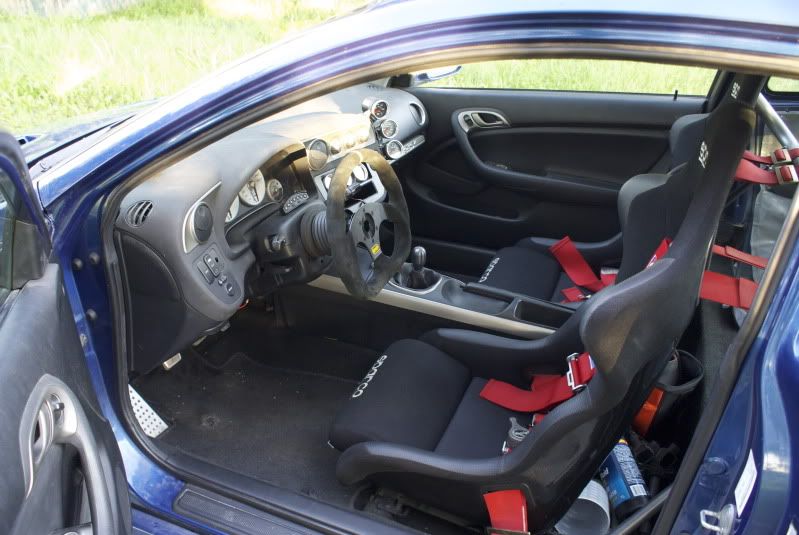

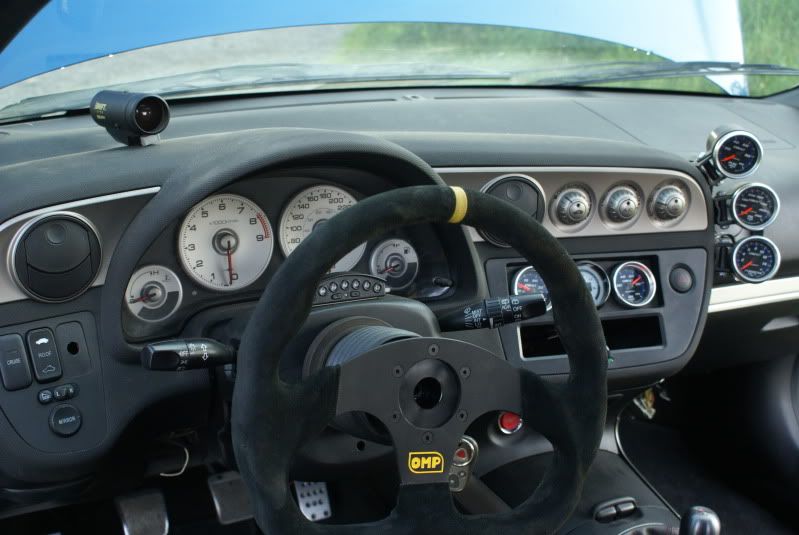

    Interior
    OMP Racing Quick Release Suede Steering Wheel
    S2000 Engine Start Button
    Sparco Racing Seats
    Sparco Racing Harness
    Cobalt Boost Gauge
    Cobalt Fuel Pressure Gauge
    Cobalt Oil Pressure Gauge
    Cobalt Oil Temperature Gauge
    Cobalt EGT Gauge
    AEM Wide Band Gauge
    Auto Meter Shift Light
    JDM Typer R Shifter
    Mugen Pedals
    Custom Dead Pedal

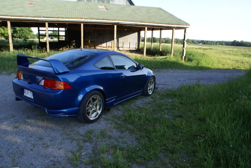

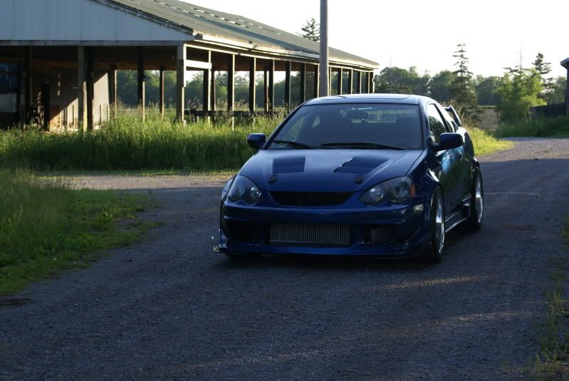

    Exterior
    Authentic JDM HID
    Max Racing Hood
    INGS Custom Wide Body
    Custom Flared Fenders
    Custom Rear Spoiler
    Carbon Fiber Front Bumper Diffusers
    Carbon Fiber Low Bumper Cannards
    Carbon Fiber Spoon Rear Diffusor
    NEW SET UP
