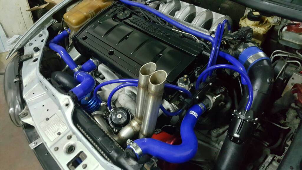

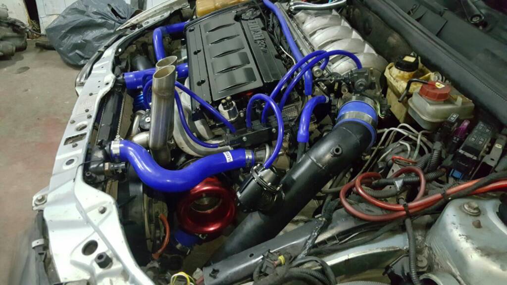

    baya zaman olmuş son güncelden sonra. turbo manifold vs bazı değişikliklerimiz oldu. kısa zamanda son setupla marşa basarız diye tahmin ediyorum güzel sonuc alıcaz inş.
    son specler ve kaput altı güncel 1-2 fotoğraf
    Megasquirt MS3X
    Custom Exhaust Manifold with seramic coating
    Gt3076
    2x38mm Tial WG
    Je Forged Pistons
    Forged rods
    HKS Filter
    Injector Dynamics id1000 injectors
    6 Paddle Clutch
    Flex fuel Sensor for E85 Fuel
    Aem Boost Controller
    Aem Fuel pump
    Custom Dump pipe
    Custom 76mm exhaust pipes
    Custom intercooler and pipes
    Custom oil rail
    Oil Cooler
    Hks Blow Off
    Aem wideband
    Apexi Turbo Timer
    Engine Monitoring System (MaxiDISPLAY)
    Iat
    Rpm
    Afr
    Boost/Vaccum
    Oil Temp
    Oil Pressure
    Wts
    Egt
