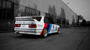

Al bunun gibi olu fiyata bir tane, at komple yuruyenle motoru, sasi gergileri, hafifletme, dodiklerle genislet alayina go ; ) hemde cokk tatli bir e30 un olur :)
http://www.performance-car-guide.co....E30-Racing.jpg
https://encrypted-tbn0.gstatic.com/i...UCy1WQq-o8DO0W
https://encrypted-tbn0.gstatic.com/i...YKUc3E5aXrtJ5N
