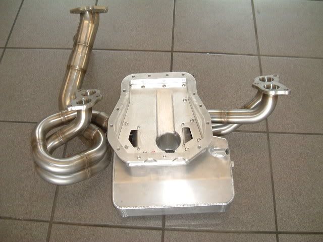

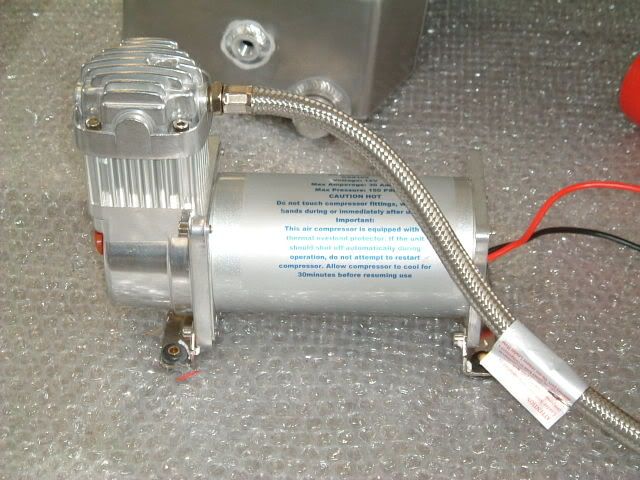

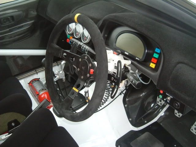

    Gobstopper Specs
    Body
    WRC steel arches WRC front and rear bumpers
    WRC carbon rear spoiler
    FIA T45 multi point welded in roll cage
    STi alloy bonnet with RCMS heat extraction vents and gas struts
    Heated front screen
    WRC non heated lightweight rear screen

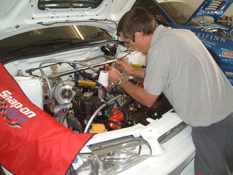

    Engine
    2.0Litre closed deck subaru block
    RCMS extreme arrow rods
    RCMS 75mm steel crankshaft
    RCMS omega flat top pistons (coated) compression ratio 9.5:1
    V4 STi cylinder heads with WRC/RCMS O-ring head gaskets and gas rings
    One piece Nimonic exhaust valves
    One piece stainless inlet valves
    RCMS uprated valve springs
    Plasma nitrided titanium spring caps
    WRC main and big end bearings

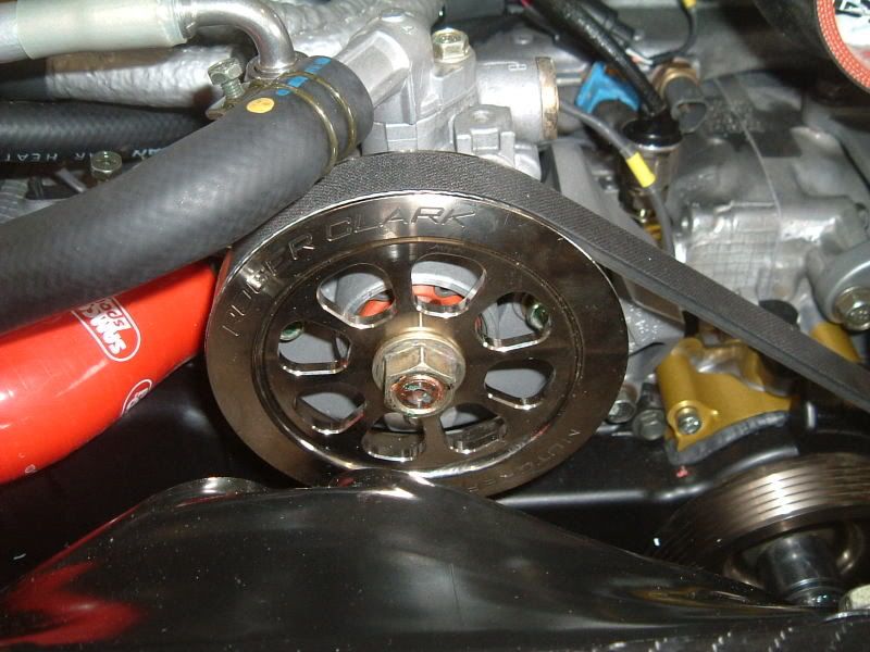

    WRC R-Profile high wrap cam belt system
    RCMS modified oil pump to suit R-Profile belt
    WRC S10 inlet manifold
    RCMS eight injector kit
    RCMS 72mm throttle body
    RCMS 5.5 litre alloy sump
    WRC short runner exhaust manifold
    Garret GT 35-40 turbo with speed sensor
    K&N air filter with RCMS 100mm inlet trumpet
    RCMS high flow intercooler with twin tube core
    70mm stainless steel intercooler pipe work
    Electronics
    M800 Motec ECU with traction control,nitrous control,anti-lag
    paddle shift control,and full engine management control and data login
    Motec dash with data login
    Defi gauges for turbo,oil,fuel pressure
    Interior
    FIA carbon kevlar recaro seats
    FIA sabelt 6-point harness
    Transmission
    R180 STi rear axle 3.9:1 cwp and plated modena LSD differential

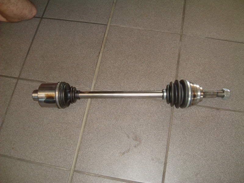

    GKN rally drive shafts front and rear
    Torque line carbon fibre propshaft
    Six speed subaru gearbox casing modified for sequential housing
    Six speed modena gear kit
    Subaru 3.9:1 front cwp
    RCMS sequential system
    RCMS paddle shift system
    Plated centre diff with 1:1 uprated output modena gears
    Plated front modena differential

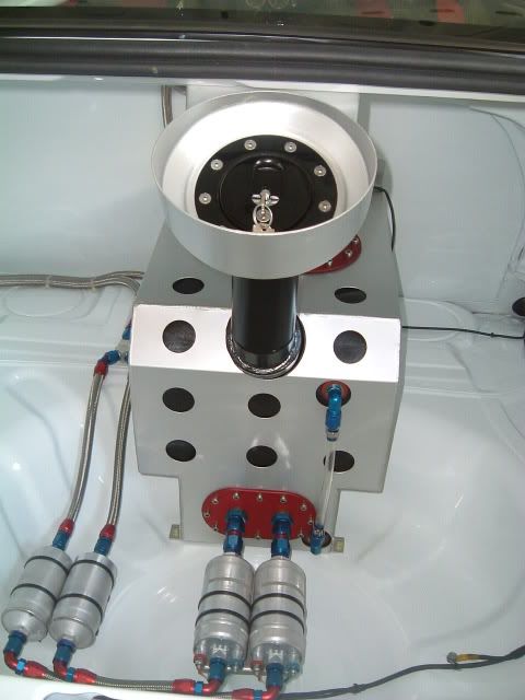

    Fuel System
    FIA spec 26 litre rubber/kevlar bag tank in aluminium cover
    Twin bosch fuel pumps (200 litre per pump)
    -8 Goodrich fuel feed pipe
    -6 Goodrich fuel return pipe
    -6 fuel cooler with cooling fan on return
    RCMS 8 injector distribution block
    2x SX fuel regulators running at 4 bar static pressure
    Suspension
    WRC spec exe-tc fully ajustable dampers
    High and low speed bump + rebound ajustment
    STi Rose jointed rear lateral links
    STi Rose jointed rear trailing links
    Exe-tc bottom rose jointed upright bushes
    STi alloy front arms (polished)
    STi quick-steer steering rack
    WRC roller bearing single piece steering column
    Momo suede steering wheel

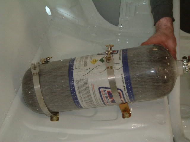

    Nitrous
    NX full wet system
    121bs carbon bottle with heater jacket
    High flow shark nozzle
    Motec auto control or driver manual system
    Ajustable from +35bhp to +400bhp
    Clutch
    RCMS spec triple plate alloy cover OS GIKEN clutch and flywheel
    RCMS hydraulic light pressure system
    Quick release dry brake fluid connection
    Brakes
    AP 355mm six pot front (track and road use)
    AP 304mm four pot front (drag strip use)
    AP 290mm four pot rear with floating discs
    RCMS hydraulic carbon handbrake
    -3 stainless steel goodrich pipe work and fittings
    Wheels
    Road/Track use 19x8 forged alloy 1 piece rims
    Drag strip use 15x8 spun alloy 3 piece rims
    Power=850 bhp
    Weight=1120 kgs
    First event:TOTB july 30th 2006
    First show:Max Power Live 29th july 2006
    Intended use:street/track/hill climbs/drag strip/time attack
