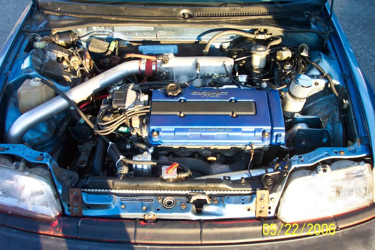

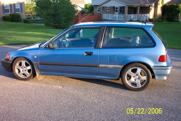

    Talking Sleeper !
    91 DX hatch stock blue paint
    Built 95 GSR
    JE 9:8:1 pistons
    .020 over bore by Eric at Performance Engeneering
    Cometic 3 layer head gasket
    Eagle H-Beam rods
    ARP rod bolts
    ARP head studs
    Type R oil pump
    Type R water pump
    Supertec springs
    Crower retainers
    Peak Performance intake manifold
    Ported GSR throttle body to match intake
    BDL fuel rail
    SX fule pressure reg
    wally 255 in-tank
    Endyn catch can
    750cc injectors
    Garrett T3/T04 turbo built by James at Diesel Injection
    SFP log manifold
    Tial wastegate
    Turbo XS BOV
    Johnny Racecar 8" front moult annodized black(super sleeper)
    3" down pipe
    3" Thermal Research turbo back
    Greddy Profec B boost controller
    Avid motor mounts
    Hasport shift linkage

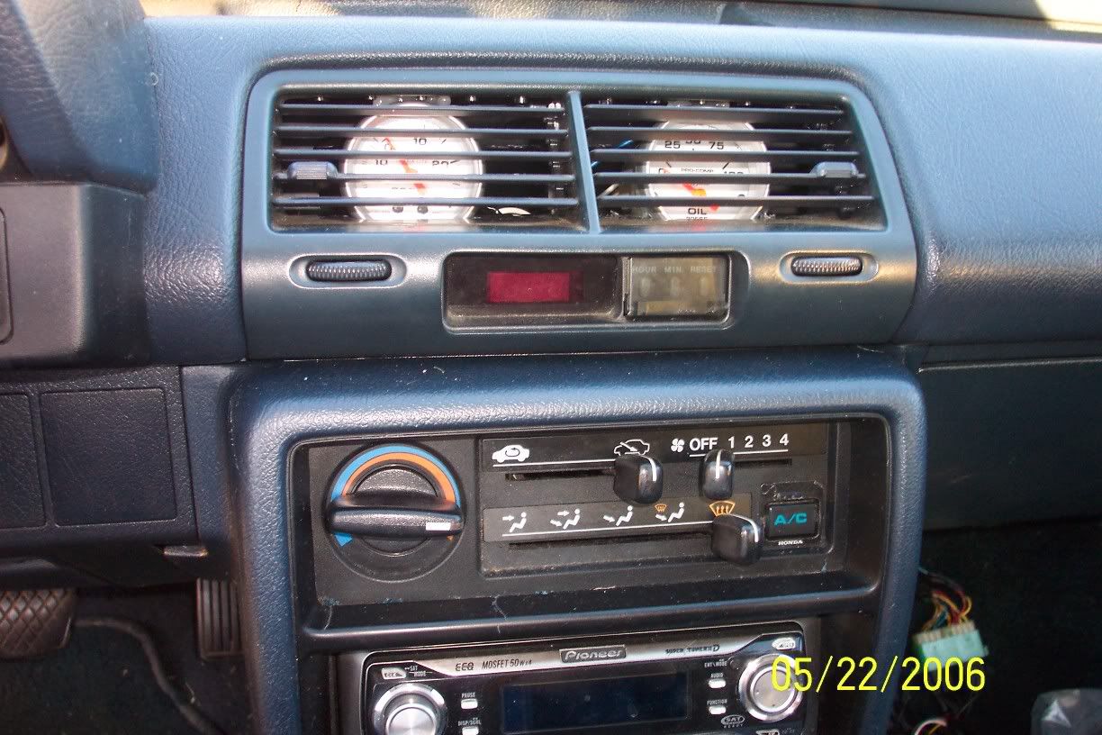

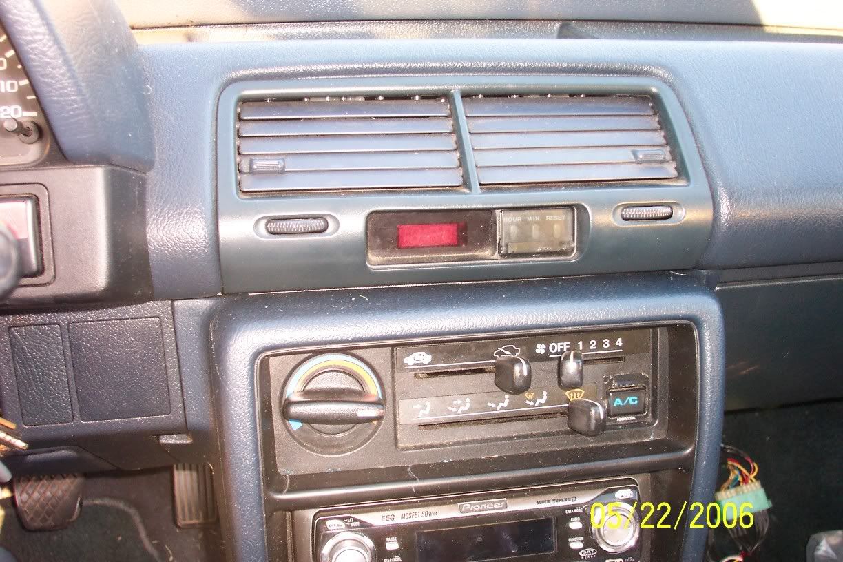

    fazla bi sleeper olmuş cidden güzel makina içerdeki göstergeler bi gizli

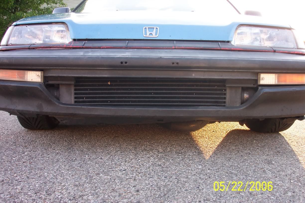

    2.5" MANDREL BENT EXHAUST W/ ES OVAL
    PAINTED BLACK FOR STOCK LOOK
    RESONATED FOR NEAR STOCK SOUND(on partial throttle
    KONI YELLOWS
    GROUND CONTROL W/ INTEGRA RATES
    Throttle body – JDM ITR bored over to 70/66
    Intake Manifold – AEBS with overbored 65 mm inlet
    Injectors – RC engineering 310 cc
    Intake Manifold gasket – Outlaw engineering
    Header – SMSP coated by Jet Hot

    gizli göstergeler farkını yansıtmış sleeperın

    gizli göstergeler çok bomba ya
