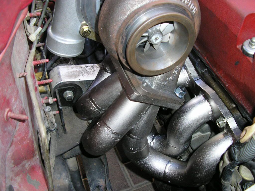

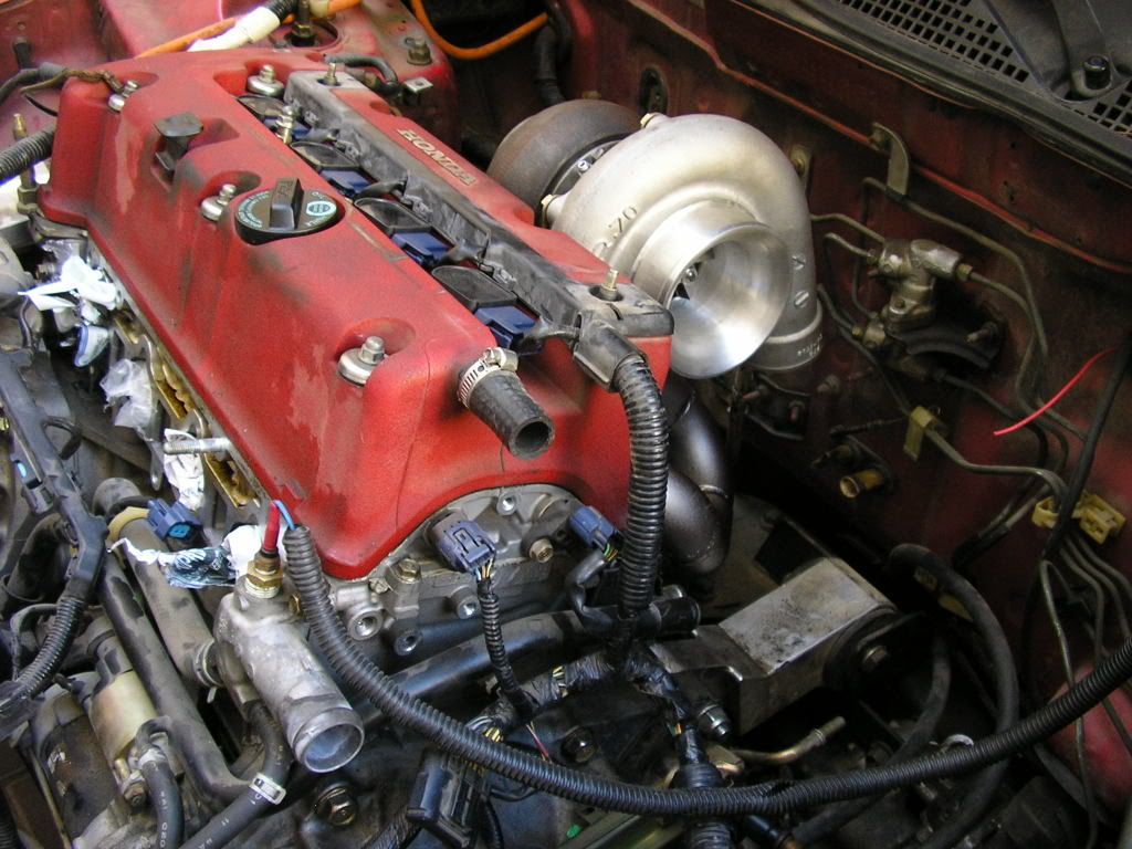

    K20A2 Engine, 6 Speed transmission, came out of a 2003 Civic type R.
    Hasport Mounts kit.
    Hybrid racing Harness + Stage III Axles (upto 550BHP).
    Karcepts Shifter + Mount.
    RSX shifter cables.
    AEM EMS 30-1070U ECU + UEGO Sensor + Gauge.

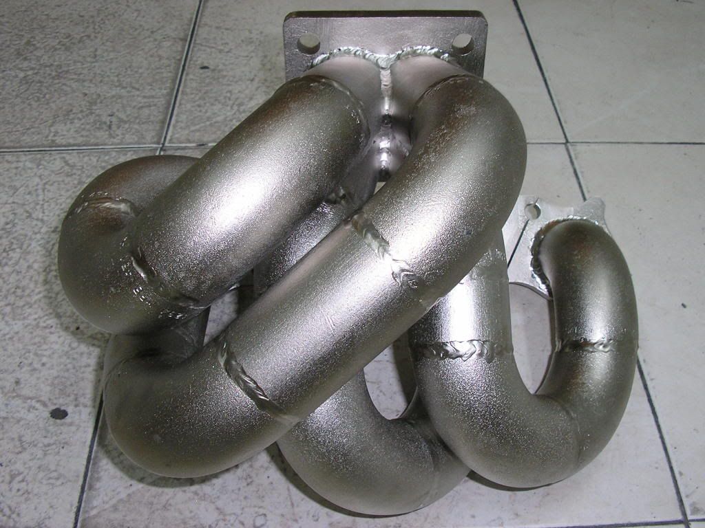

    Custom TIG ART Turbo Kit which includes:
    Custom made Tubular Topmount Manifold.
    3.5" Downpipe, 3.5" exaust, 3.5" Muffler (all the way 3.5" support over 1000bhp).
    Boost pipes 2.5" from turbo to intercooler, and 3" from intercooler to throttlebody.
    HUGE 4" Intercooler (upto 1000bhp).
    Custom made intake pipes.
    Custom made type R Manifold (we've changed the original manifold and built a a "boost chamber" for it.
    Tial 44mm Wastegate
    Tial 50mm BOV
    custom 10mm fuel system from the fuel tank to the engine bay.
    Walbro 255 Fuel Pump.
    Aeromotive fuel filter.
    Aeromotive fuel pressure regulator + Gauge.
    Golden Eagle fuel rail.
    RC 750CC Injectors
    Hondata Intake Gasket
    Clutchmasters Stage 4 Clutch (upto 540bhp)
    Clutchmasters lightweight flywheel.
    Fluidyne Radiator.
    AEM 3.5 Bar Map sensor
    Greddy Profec B Electronic Boost controller
    Autometer Boost Gauge
    Buddy Club Race Spec Damper Coilovers + Rear Integra Control Arms.
