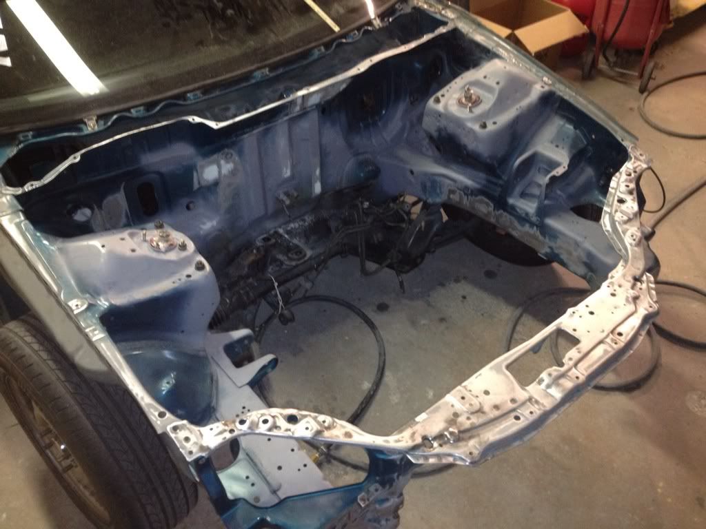

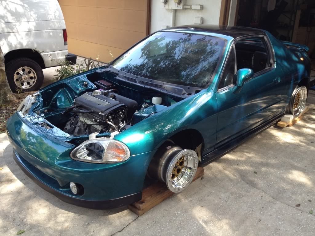

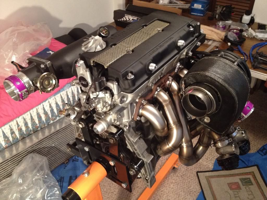

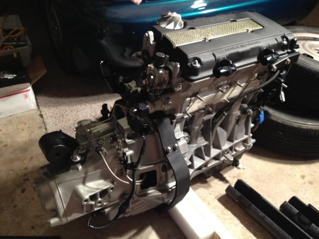

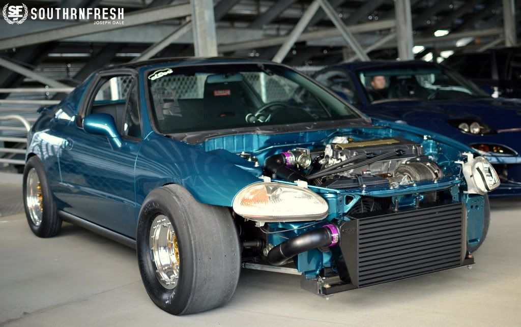

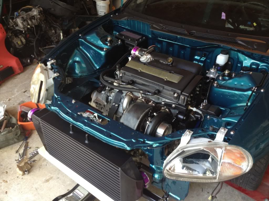

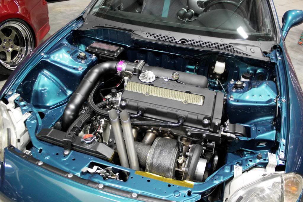

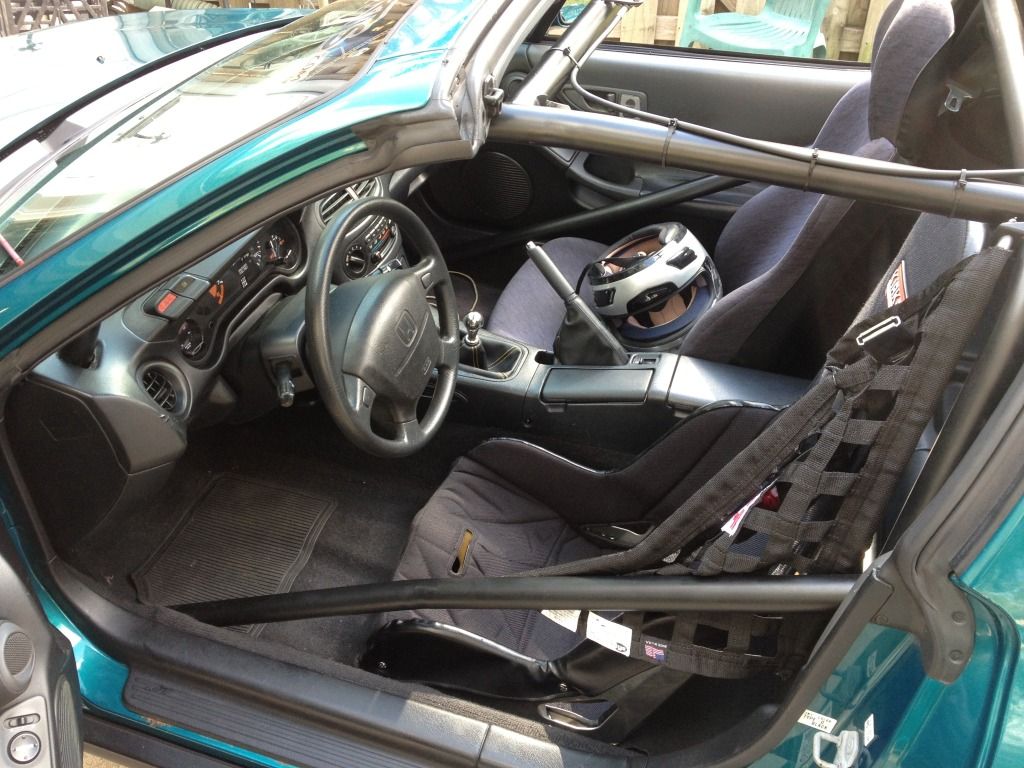

    62mm Honda Del Sol build for 2013!
    Couple pictures of the car before it all came apart

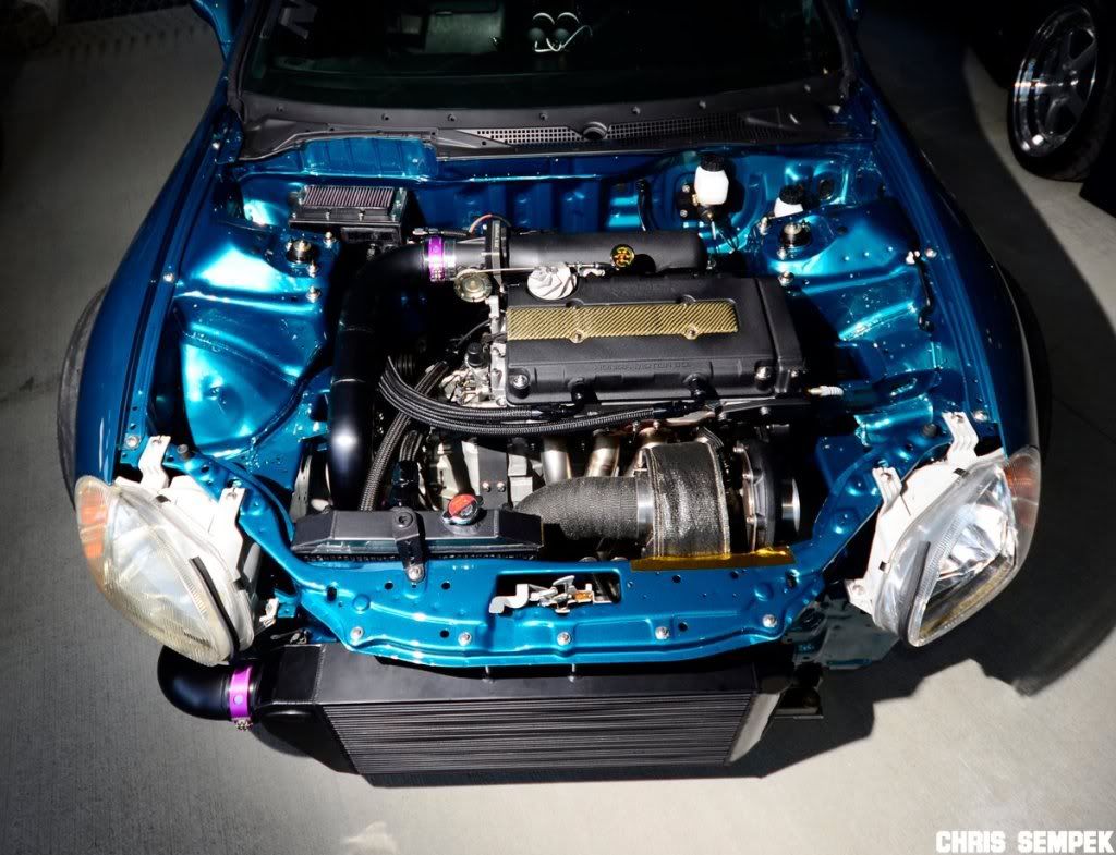

    Engine:
    84mm AEBS GSR block
    9:1 CP pistons
    Carrillo Pro-H rods with CARR bolts
    ARP head/main studs
    STOCK port head
    Supertech valvetrain
    Turbo Camshafts

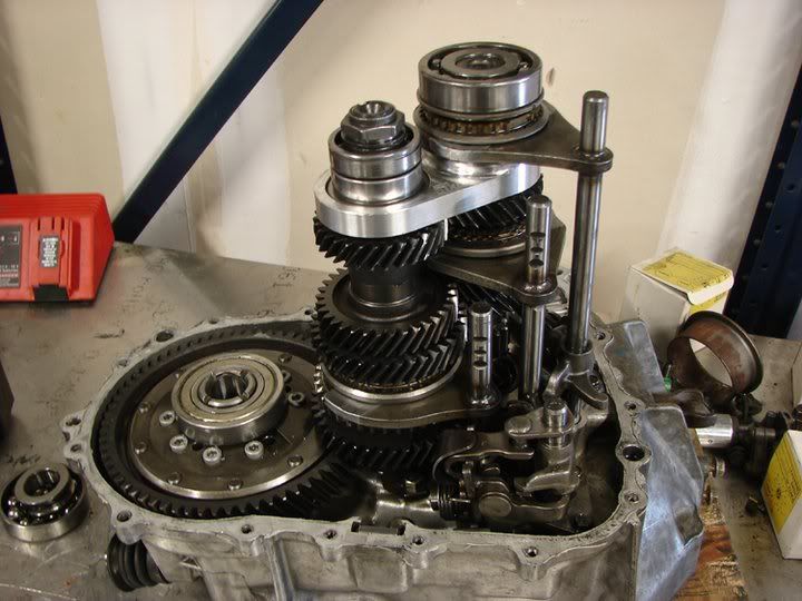

    Trans/Driveline:
    Stock GSR gearset
    Treated gears
    Carbon synchros
    Cuff
    Quaife LSD
    Tilton twin disk
    DSS 5.9’s
    Electronics:
    Motec M4
    M&W pro14
    CBR coils
    T1 trigger setup
    Turbo setup:
    Borg Warner cast wheel 62mm
    Turbo manifold
    Twin Tial MVS
    Tial Q
    3” Charge piping
    3.5" open DP
    T1 intercooler
    Edelbrock Victor-x
    Edelbrock 76mm throttle body
    Fuel:
    ID1000
    Dual Bosch 044
    Weldon FPR
    -8 feed/-6 return
    Suspension:
    Drag coilovers
    Custom traction/weight bar setup
    New Hardrace bushings all around
    Failure is not an option.

    Kullandıkları Gömlek ne marka ? Birde CBR coil dedikleri motorsiklet bobini mi. Yeterli ateşlemeyi sunuyor mu ?
    Gömlek AEBS.
    cbr coil, motorsiklet bobini.
    Sunuyor.

    açıkçası gördüğüm en güzel delsol.

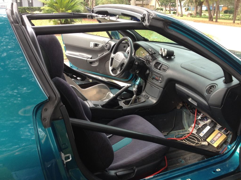

    koltukarda alüminyum bu arada fenaaaa...
