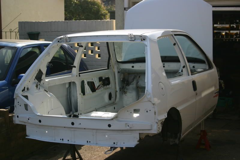

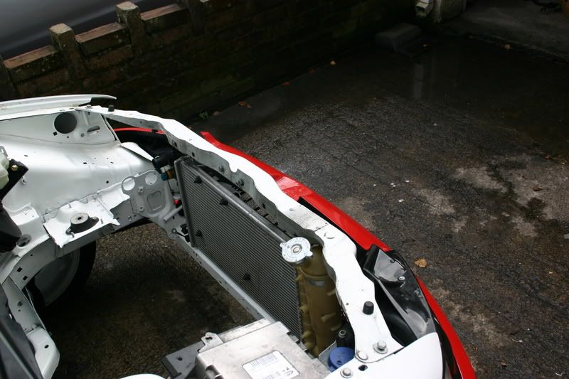

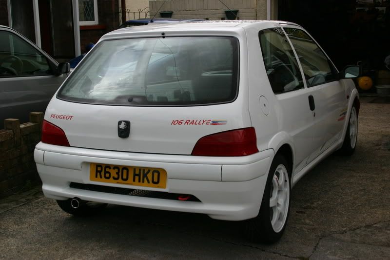

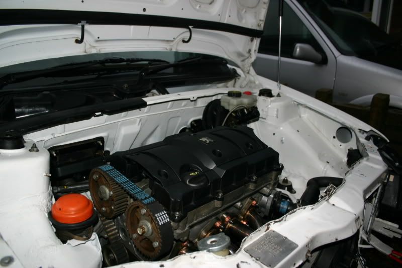

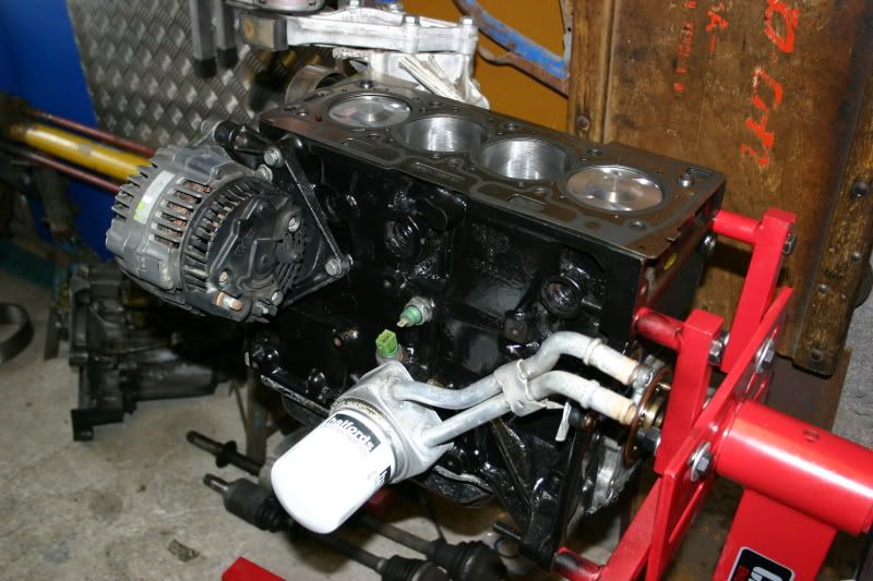

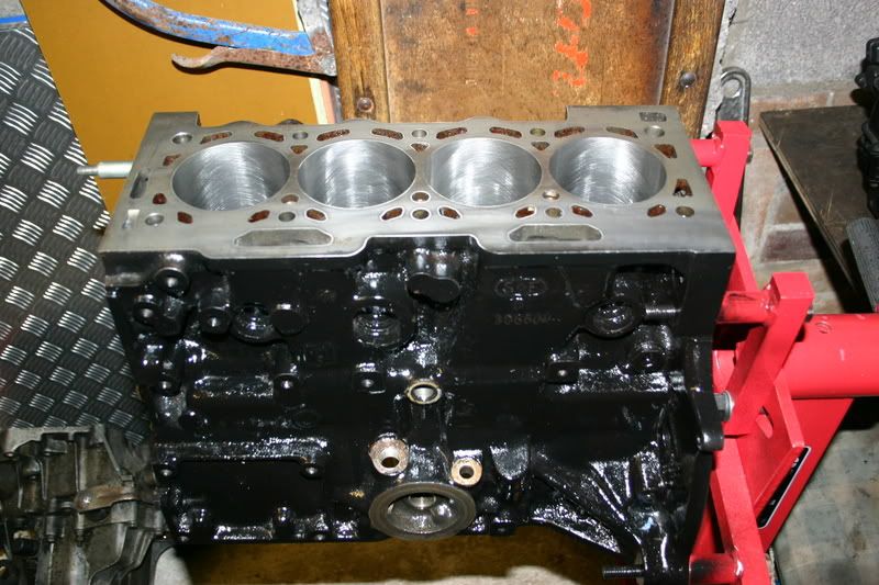

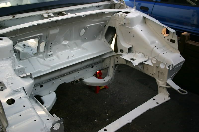

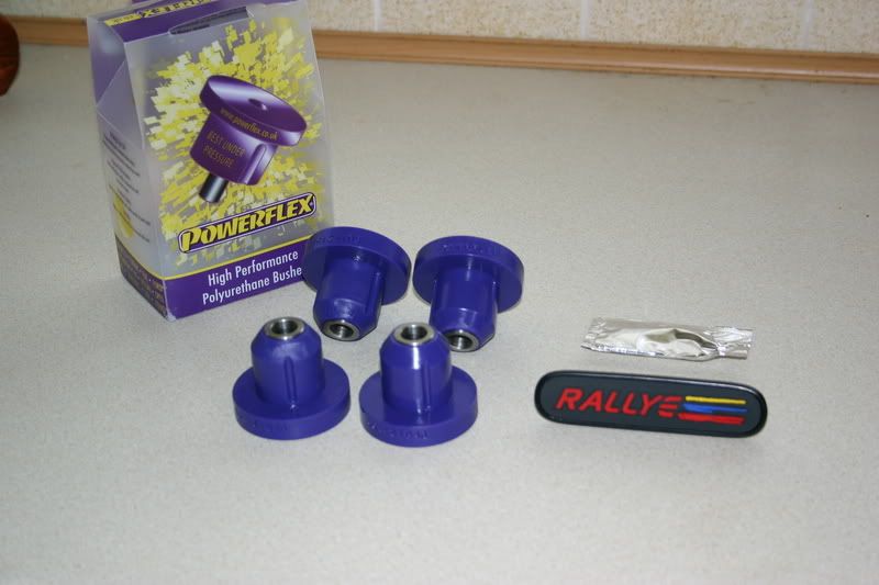

    Spec

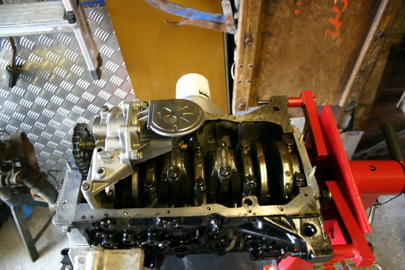

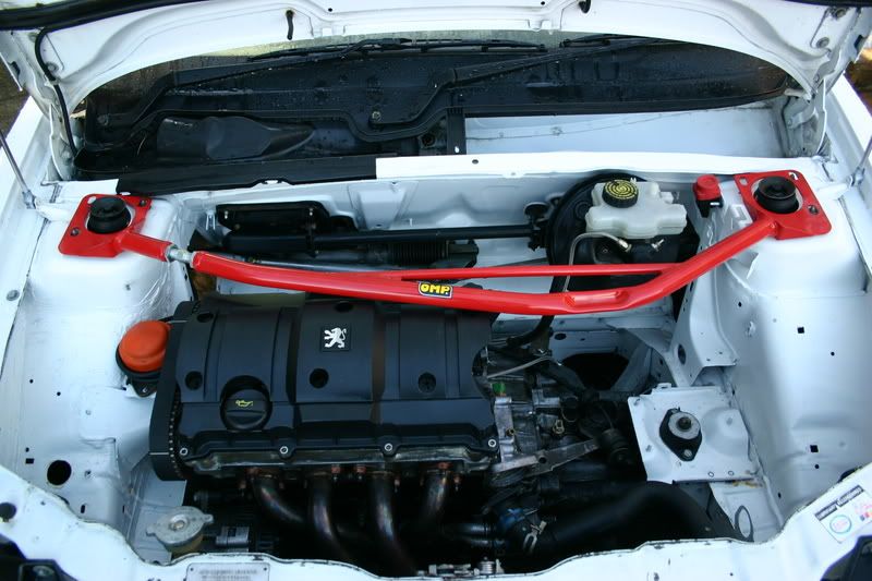

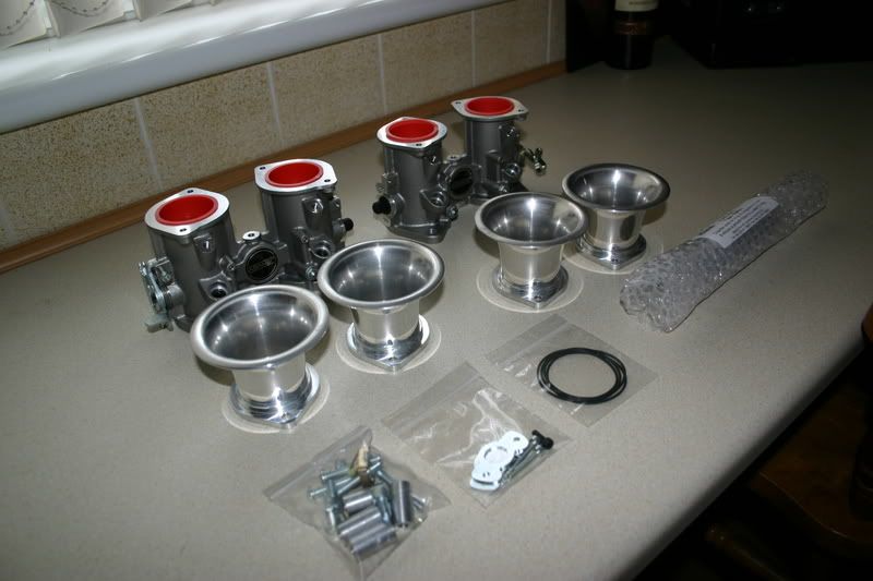

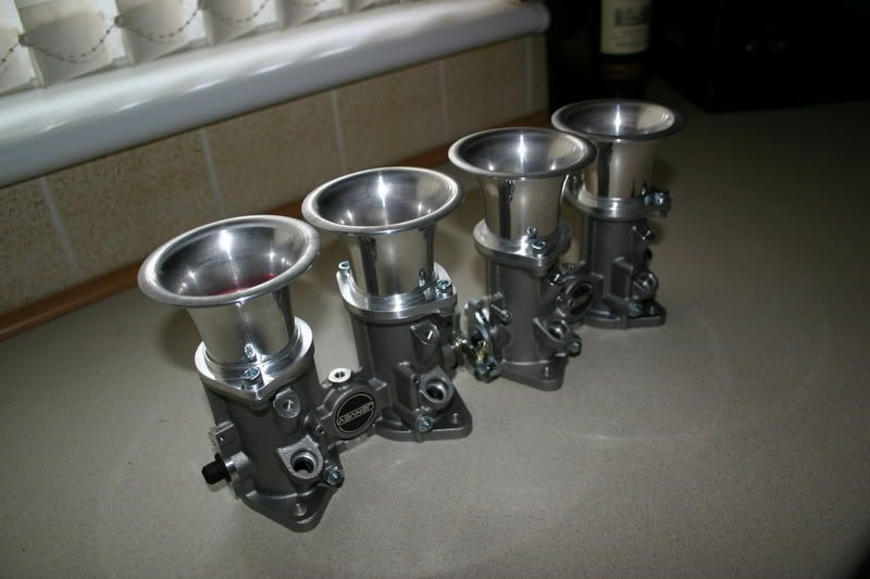

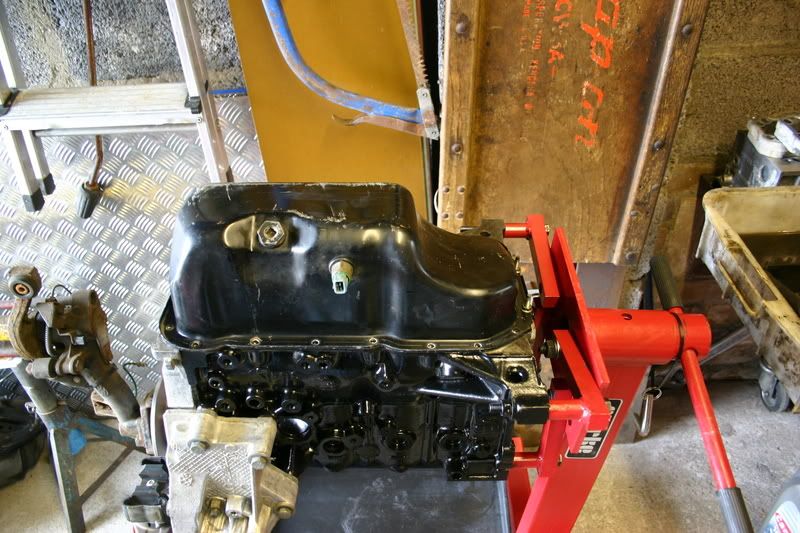

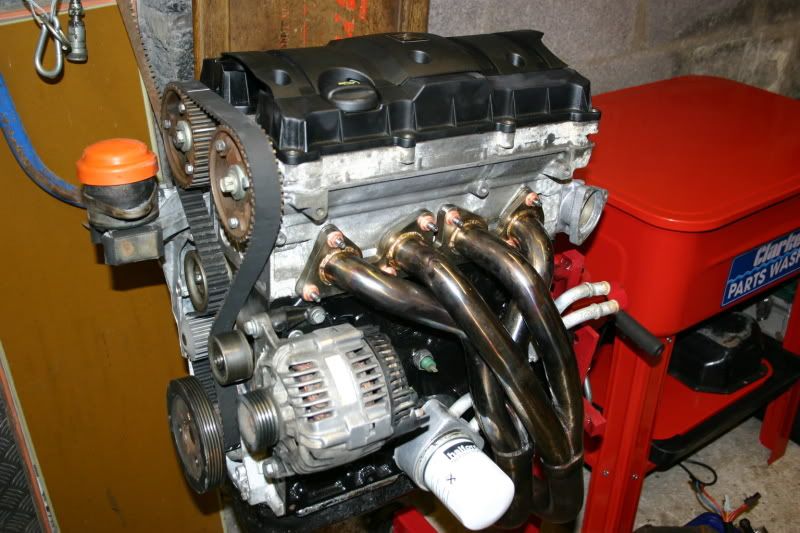

    Engine:

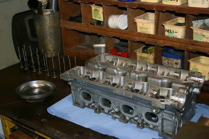

    o 206 XSI 1.6 16V Engine.
    o 206 XSI Big Valve Head.
    o 106 GTI Valve Springs and Followers.
    o Sandy Inlet Manifold, Jenvey TH42, tapered to 45, running 60mm trumpits
    o 106 XSI gearbox Fitted with a Quaife ATB Limited Slip Differential.
    o Peugeot Sport Group N Cams X2.
    o DTA S40 Management
    o Sandy Brown Custom engine loom
    o Peugeot Sport group A engine mounts all Round.

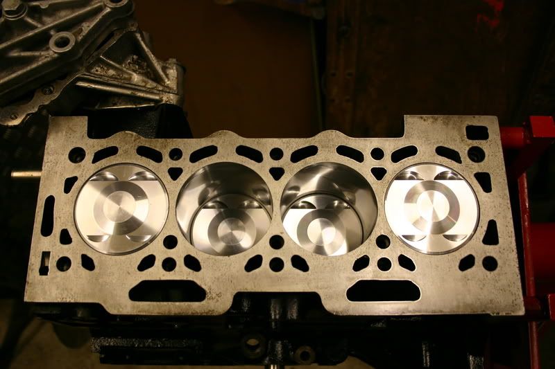

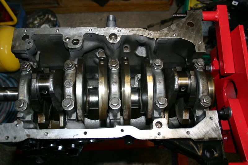

    o Full Bottom end rebuild, all new big end bearings and main bearings.
    o JE High Comp Pistons.
    o Lightened Flywheel.

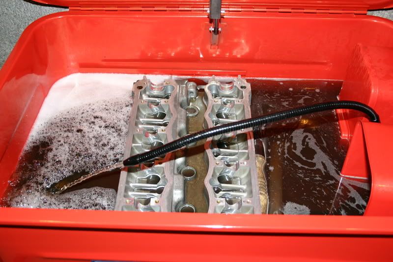

    o Skimmed off block (to remove burrs prior to rebuild).
    o Ultrasonically cleaned Clio 182 injectors.
    o 3.5 bar FPR.

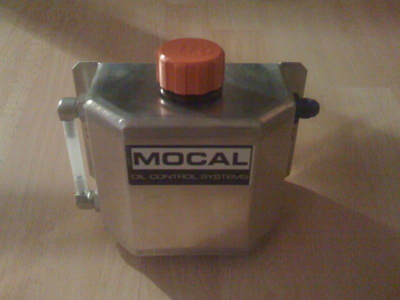

    o Mocal Oil catch tank.

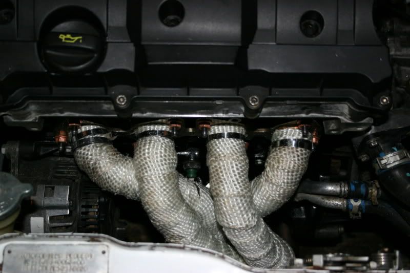

    o Raceland 4-2-1 exhaust manifold (White Heat Wrap).

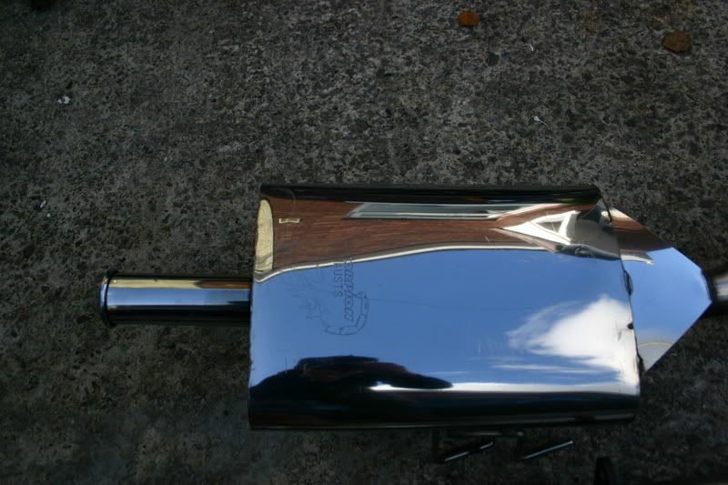

    o Peugeot Sport group N exhaust system.
    o Nissans alloy core radiator.
    o Packet group N Cooling fan.
    o Blue Samco coolant hoses.
    o Powervamp Battery.
    o Earls aero quip fuel lines running through the car.
    o Earls Filter.

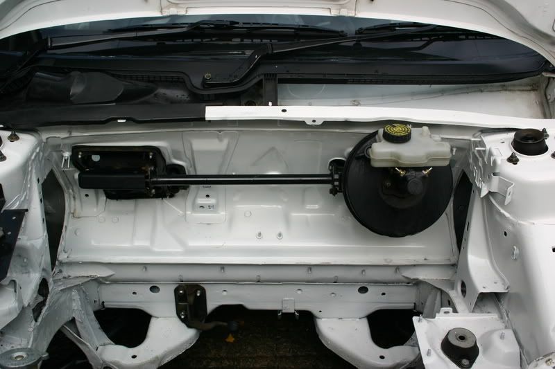

    o Earls aero quid brake lines running through the car with wildwood bias valve.

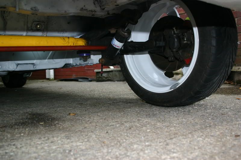

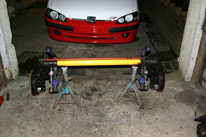

    Suspension:
    o Peugeot sport coil over Gravel Spec Shocks all round
    o Faulkner’s custom Springs on the front 300lbs
    o 22mm Anti Roll Bar
    o 106 GTi Rear Beam With Disks
    o Rear ride height adjusted to suit
    o Power flex rear Beam Bushes
    o Power flex Anti Roll Bar Bushes
    o Power flex bottom arm Bushes
    o New OEM drop links
    o New OEM bottom arms

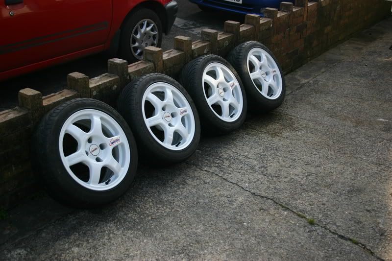

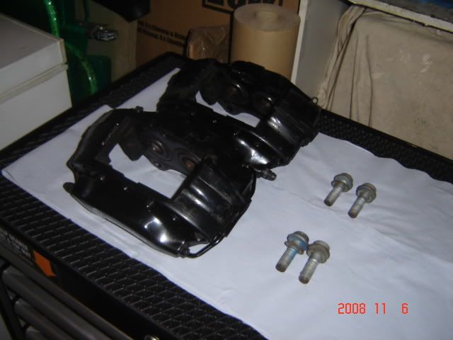

    Brakes/Wheels:

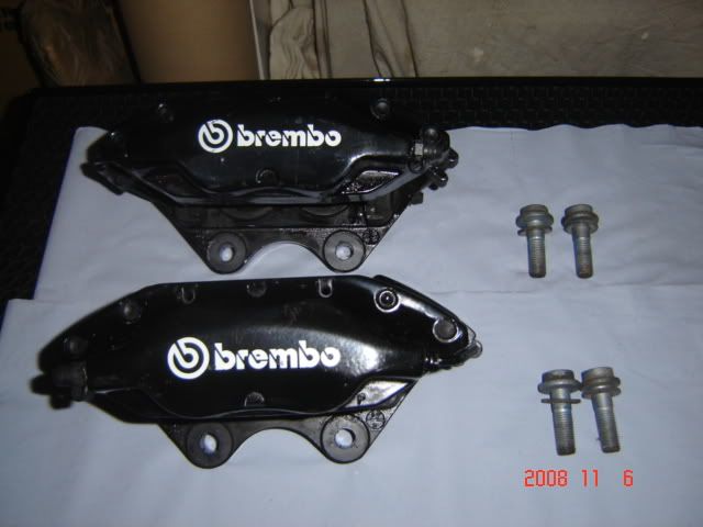

    o Brembo 283 front brake conversion
    o Mintex grooved front and rear disks
    o Mintex 1444 pads all round
    o Speedline Comp 2 Alloys
    o Toyo Proxies T1R Tyres all round 195\45\R14
    o Earls Brake Lines With all fittings to calipers

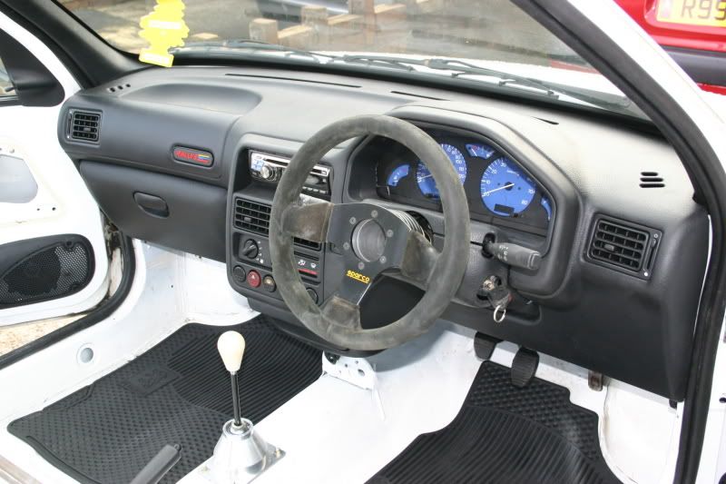

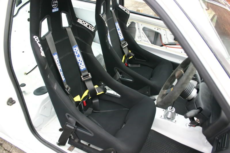

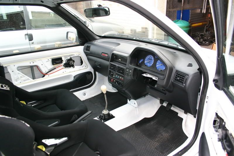

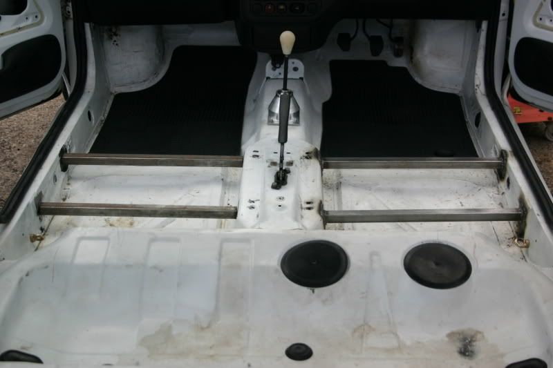

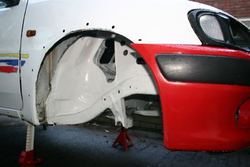

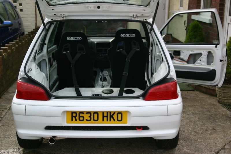

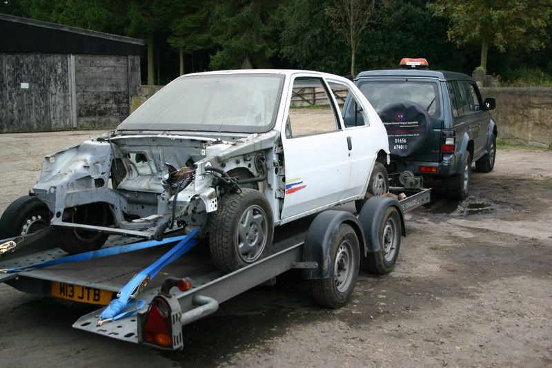

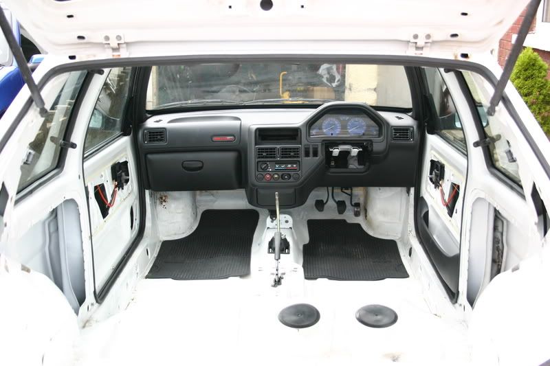

    Inertia:
    o Fully striped out inside
    o 1” box section welded in for seat frame
    o Sparco Suede Pro steering wheel 280mm
    o Sparco black sprint seats x2
    o Sparco side mounted sub frames

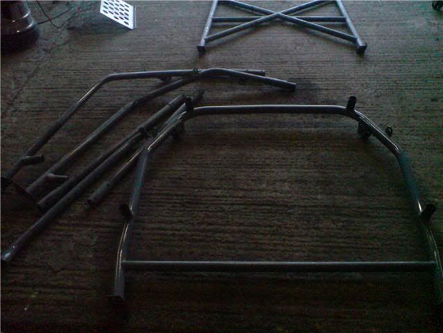

    o Safety devices 6 point harnesses x2

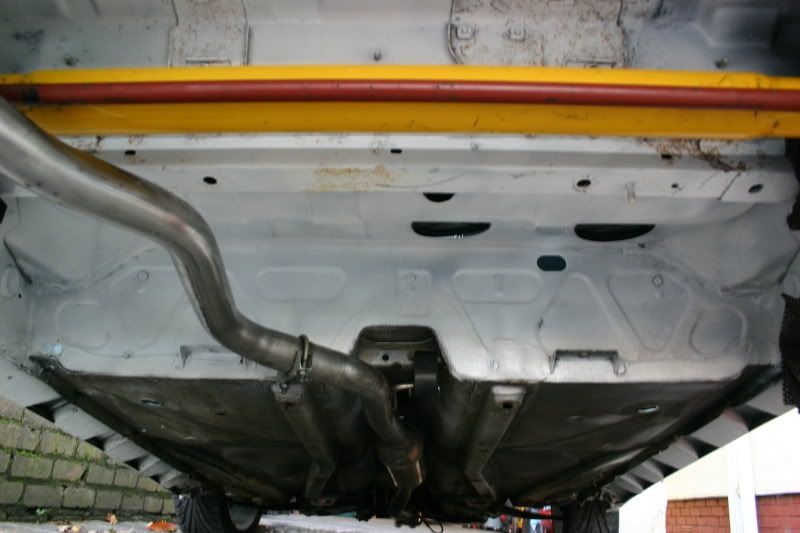

    o Safety devices 6 point Cup Roll Cage
    o Comp brake quick shift
    o Quaife gear knob
    o Full seam welded through out the car and engine bay
    o Fully sprayed inside matching outside
    o TRS Cargo Net

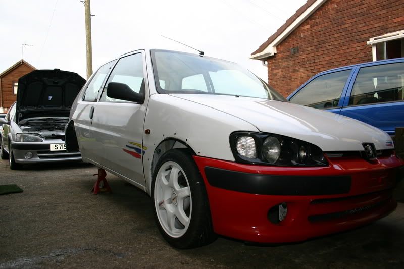

    Extra:
    o All dents stone chips removed
    o Front and rear bumper re-sprayed
    o Arches and side skirts re-sprayed
    o New decals all round
