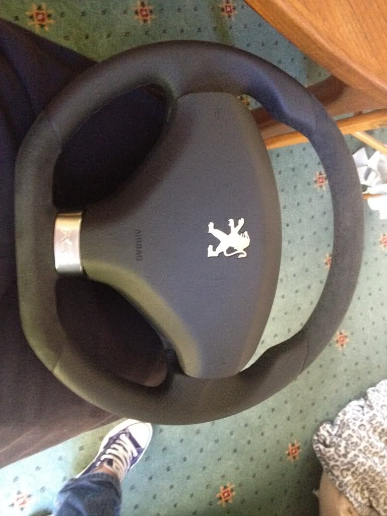

airbag level 2 ignition is switched off via Planet so don't get the warning light on the dash as their is spare connector behind the wheel.

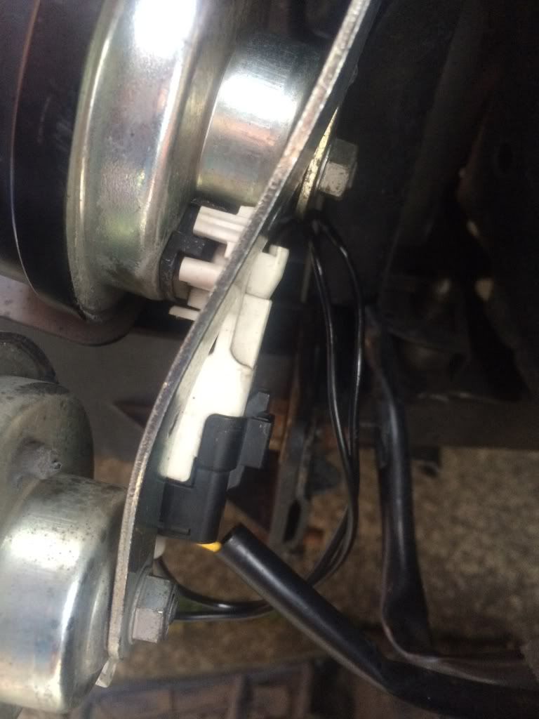

over the last week or so, the horn has been playing up, so took bumper off this morning, checked was getting power, dismantled the horn, cleaned the contacts and refitted. works again lol
http://i270.photobucket.com/albums/j...ps4281accd.jpg
its the white connector going into the black that seemed to be the issue but cleaning seems to have sorted it.

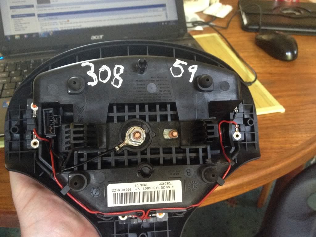

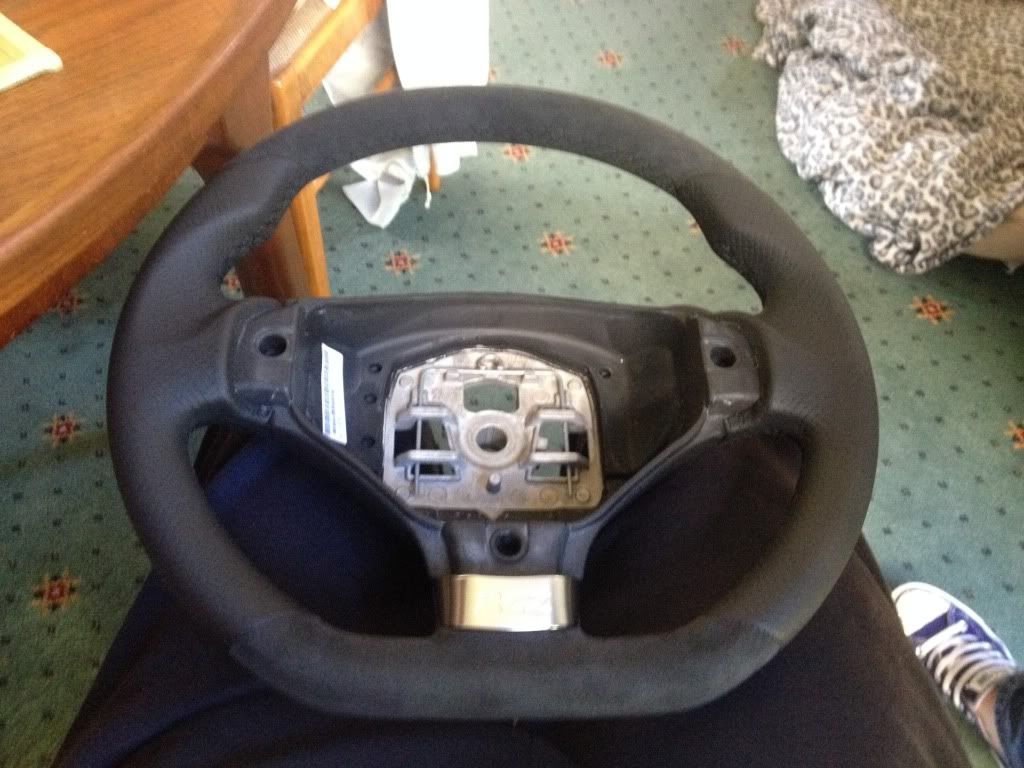

with it being different plug set up on the rear, we are looking at ways of bypassing this so air bag works, kinda tricky but we will sort something !
might in short term for town driving and meets etc install it and turn air bag off, then for any motorway long journeys and bad roads just swap over to my gti one, only a 5min job to do so.
