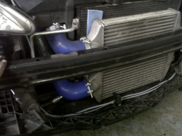

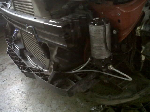

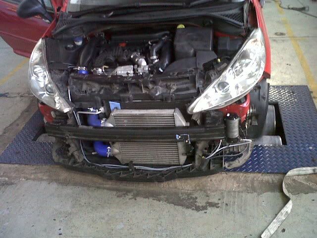

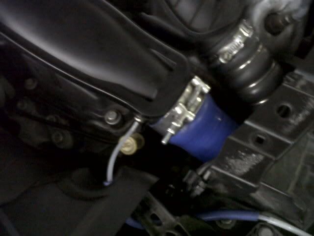

Hi guys... Well this week saw me get bored... So installed a Frieling Racing water injection system.....
It makes a big difference!!!!!
Here are a few pix... Excuse the quality and lack of a ton of pix.. But wanted to get the install done and dusted...
Only pic I never took was the controller unit.. Will update pix tomorrow with it showing the controller situated in the glove box and the Switch I will mount in the dash to show the system is on or armed or off....
The water injection pump
http://i1006.photobucket.com/albums/...00908-1300.jpg
the system solonoid shown under IC
The injection point.....
http://i1006.photobucket.com/albums/...00908-1259.jpg
Car on the dyno so we could tweek the kit
http://i1006.photobucket.com/albums/...00908-1319.jpg

[quote author=Lee_rsa link=topic=7873.msg95332#msg95332 date=1284065714]
Well we tested with water and not meth... Without it on it makes 183wbhp and active 196wbhp... We are currently re-doing the mapping as I need to pull the timing a little more.... There is zero "pinking" at 1.5 bar boost... So timing is'nt the issue... We wanna do the map so I deliver the torque a little later and hold it longer... but the boost is good.. holding 1.3 bar @ 6300 rpm...
